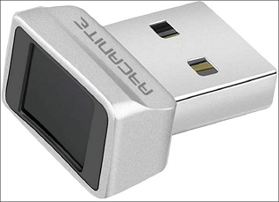

To protect your data is as simple as to lock your computer whenever you leave it.
And to get back into the system as easy, fast and comfortable as possible get a USB fingerprint sensor like this one:
I know that this is not what you are asking for. But it is what you can do right now to protect your data.
